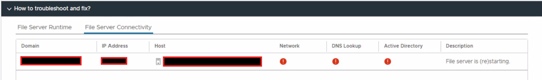

  • vSAN skyline health for the File Server Connectivity show File server is (re)starting. warnings for one of the file server.
  • One of the file server (example: vsanfs01) or container restarting on a continuous basis and may show up on a different host as it choose different FSVM to start as host.
  • We may see the container is starting and mark for failover after waiting for a period of time. This happens every minute or two minutes.
  • From vCenter UI for vSAN health, it shows the warning for file service health as below.
    • Example NFS Server name: vsanfs01
    • Example NFS share: nfs-share
