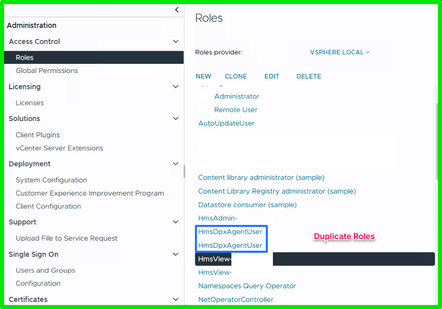

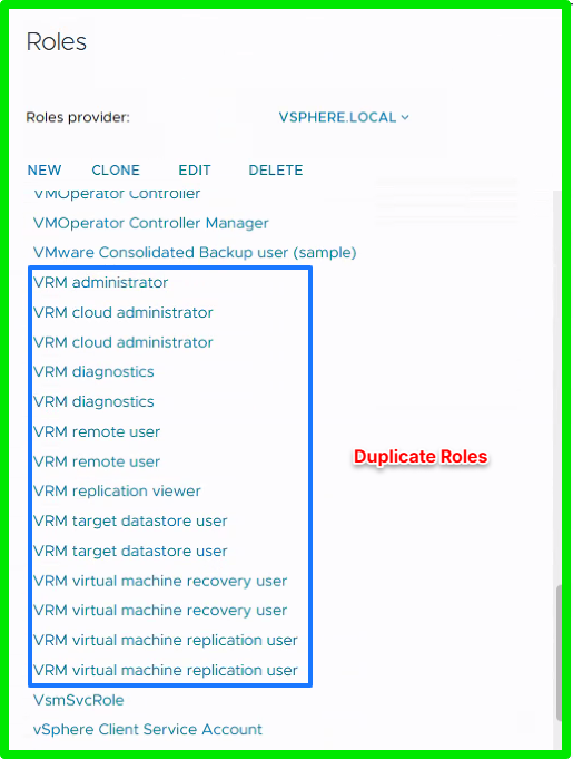

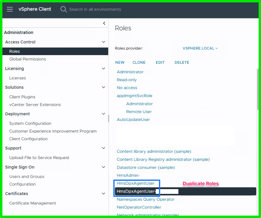

This is caused due to a race condition within the VMware Directory Service (vmdir) and the Authorization Manager when operating in Enhanced Linked Mode (ELM).
When you perform a RECONFIGURE on the VLR Appliances simultaneously, it creates duplicate HmsAdmin roles. Because vCenter (SSO) replication is asynchronous, either sites (Protected or Recovery) don't know that a SolutionRole is being created parallely. Because of this race condition, vCenter ends up creating 2 distinct RoleIDs sharing the same RoleName thus breaking the unique name constraint that the va-configurator (VLR Appliance) relies on.

When performing a RECONFIGURE on VMware Live Recovery (VLR) appliances in an Enhanced Linked Mode (ELM) environment, parallel execution causes a race condition in the Authorization Service. This leads to duplicate Solution roles and "AlreadyExists" faults.
Follow the workaround below to ensure a clean configuration.
OPTION 1:
This is the best practice for an initial deployment or a clean reconfiguration.
Site A (Production): Initiate the RECONFIGURE task on the VLR Appliance. Wait for the task to finish. Log into the vSphere Client and verify that the Solution Roles (HmsAdmin, SRM Administrator, etc.) are visible under Administration > Roles and that there are no duplicates present.
Wait an additional 15 minutes to allow the VMware Directory Service (vmdir) to replicate these new metadata objects to all partner vCenters in the SSO domain.
Site B (Recovery): Only after verification and the wait period, initiate the RECONFIGURE task on the second VLR Appliance.
OPTION 2:
Use this if a previous parallel RECONFIGURE attempt failed and the environment is now "dirty" with duplicate roles or stale registrations.
Service Registration Cleanup (vpxd MOB):
Navigate to the Managed Object Browser (MOB): https://<vcenter-fqdn>/mob/
Click on Content > ExtensionManager and UnregisterExtension com.vmware.vsan.snapshotservice
LDAP Cleanup (JXplorer):
Install JXplorer
Delete Service Registrations: com.vmware.dp
Delete Service Principals:
h5 (HTML5 UI components)
SRM / HMS
dpx-agents
snapservice
Ensure that no duplicate roles named HmsAdmin exist in the LDAP tree. If duplicates are found with different IDs, delete both to allow the next RECONFIGURE task to recreate a single, clean identity.
Follow the process OPTION 1 to RECONFIGURE the Appliances.
