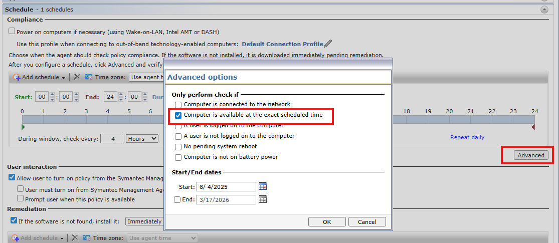

Additionally, if a policy must execute strictly at its scheduled time, configure the schedule to use the Exact execution modifier ("Computer is available at the exact scheduled time" checkbox) in the schedule advanced settings. This ensures the policy will only run at the exact scheduled time and will not execute later if the schedule is missed.

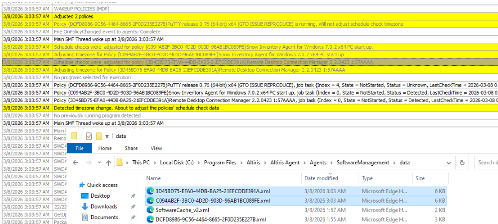

Relevant policy data is stored under:
C:\Program Files\Altiris\Altiris Agent\Agents\SoftwareManagement\data\<GUID>.xml
Example Agent Log Entries
The following log entries may be observed after the fix when a timezone change occurs:

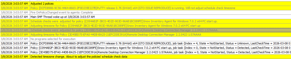

Detected timezone change. About to adjust the policies' schedule check data
Adjusting timezone for Policy {GUID}
Schedule checks were adjusted for policy {GUID}
Adjusted X policies
Policy {GUID} is running. Will not adjust schedule check timezone
Schedule checks were adjusted for policy {GUID} ... EXAMPLE POLICY NAME
