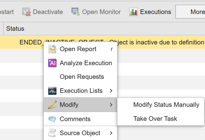

5) Go to the Process Monitoring tab and notice that the task is ended with status "ENDED_INACTIVE_OBJECT - Object is inactive due to definition."
6) Click on the task or right-click on the task

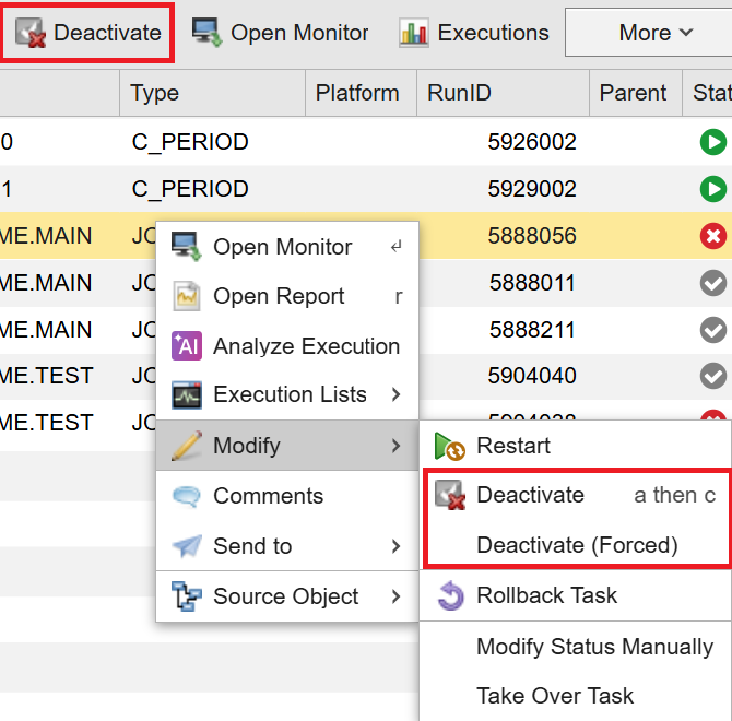

Expected behavior:
  Deactivate is a button choice in the Process Monitoring perspective or right-click, Modify -> Deactivate is available in the context menu like you see with other objects
Actual behavior:
  Deactivate button is grayed out and context menu option is not available in any way from the Process Monitoring perspective
