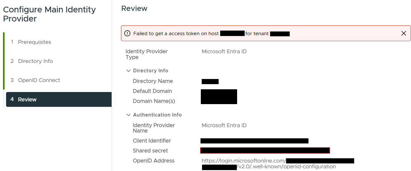

When attempting to add an Entra ID provider configuration to the vCenter, the process fails with the below error:
  • Failed to get a access token on host <IPAddress> for tenant <TenantName>
