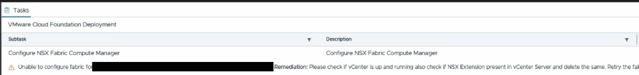

  • During deployment, the task “Configure NSX Fabric Compute Manager” fails with the error:  "Unable to configure fabric for vcenter.domain.local on nsxmgr.domain.local".
