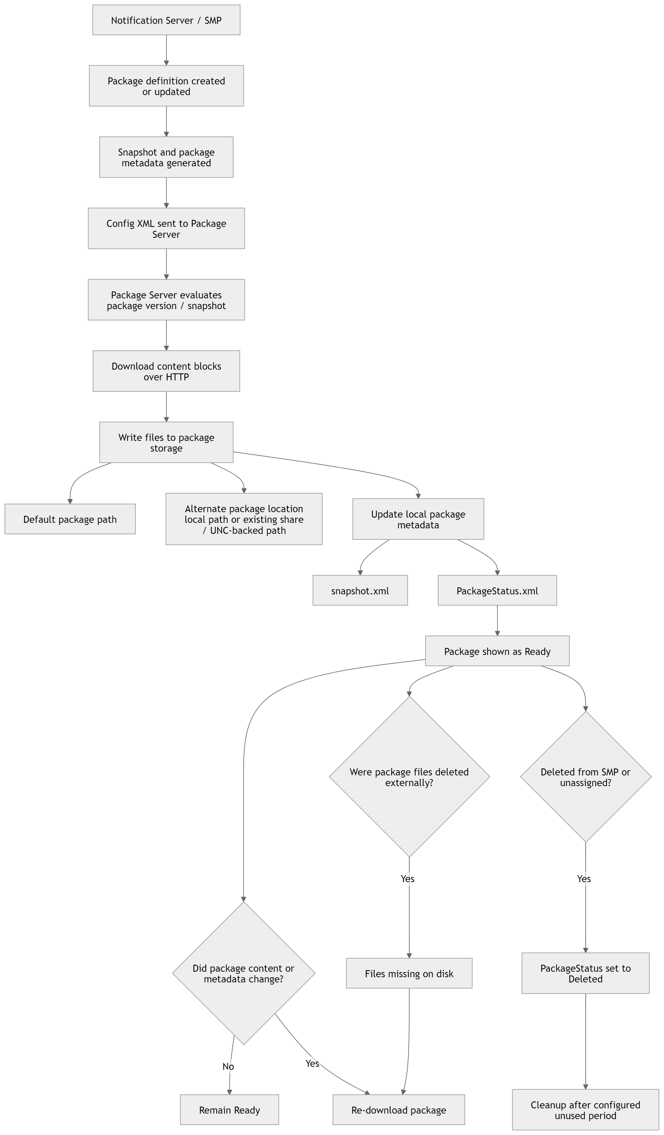

Visual Reference — Full Process Flow
Architecture diagram of the ITMS package distribution pipeline
This diagram reflects the process described in the main Use Case: package metadata originates on the SMP Server (NS Server), Package Servers receive package definitions and snapshots, content downloads in blocks over HTTP, content may be stored in an alternate local/UNC-backed location, and package state is tracked by PackageStatus metadata.

Main control points in the pipeline
Control point What the example case shows Product behavior tied to it
Snapshot / package metadata Re-downloads happen when package is considered changed Package versioning and snapshot handling are core Package Server behaviors; also package snapshot handling for alternate locations.
Download method Package blocks are downloaded over HTTP The case logs show block-level HTTP retrieval.
Alternate location Customer used \\%COMPUTERNAME%\Share\... mapped to a physical path Broadcom documents that a non-default Package Server location can be a local path or an existing shared folder and that Package Server does not create the share for you.
Ready / Deleted tracking Ready” state could exist while physical files were missing Cleanup state is tracked through PackageStatus.xml and evaluated during refresh.
Cleanup logic Customer tested deletion of package files from alternate location Ccleanup starts after package deletion or unassignment, then PackageStatus.xml is marked Deleted, and cleanup occurs on refresh after the configured period.

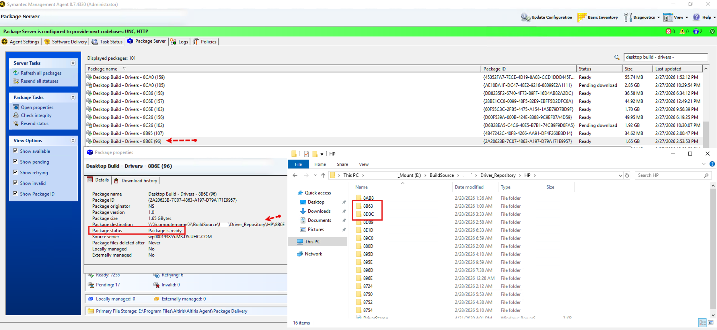

Step 2: Verify whether the physical files exist at the alternate package path
Compare the package path recorded in snapshot.xml with the physical file system on the Package Server.
Expected
  • Files listed in the package snapshot exist on disk.
Actual in the reviewed case
  • Package was shown as Ready, but the folder referenced in the snapshot did not exist on disk.
Screenshot of Package Server UI showing Ready state and a matching file system view showing missing files

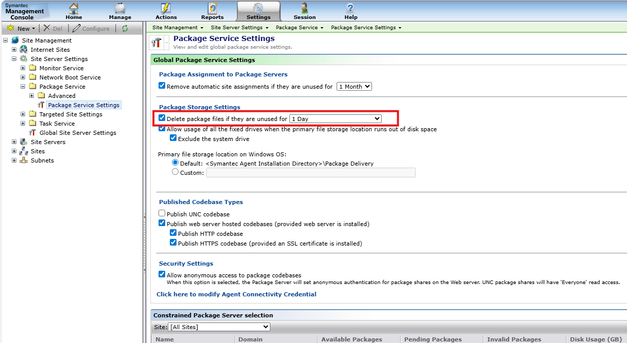

Step 6: Review package deletion settings
On the Package Server settings (under SMP Console > Settings > Notification Server > Site Server Settings > Site Server Settings > Package Service), review:
  1. Delete package files if they are unused for
  2. Any registry customizations affecting cleanup interval
Package cleanup begins after the package is removed from configuration and PackageStatus.xml is updated to Deleted; cleanup is then evaluated during Package Server refresh.
