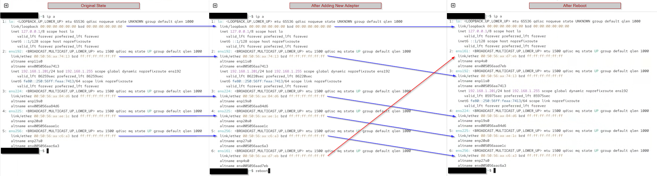

When a new Network interface is added to a Linux VM, it will appear not as the last added interface after the VM is rebooted. Due to this, the MAC Address of the interfaces sequence are shuffling.
Here is a sample of the change of sequence inside the guest OS simulated in lab:
If there are any reference to the sequence of the interface instead of it's name (i.e. Interface 2 instead of ens192), since the MAC Address of that sequence will be different, the reference will not be able to find the same MAC Address.The sequence is not scrambled on the virtual hardware, but on the guest OS only.
The ethernet interfaces are correctly associated with the MAC Address with no changes on the sequence in the virtual hardware.

Note that ens256 and ens225 were already on different sequence when ens161 was added.
