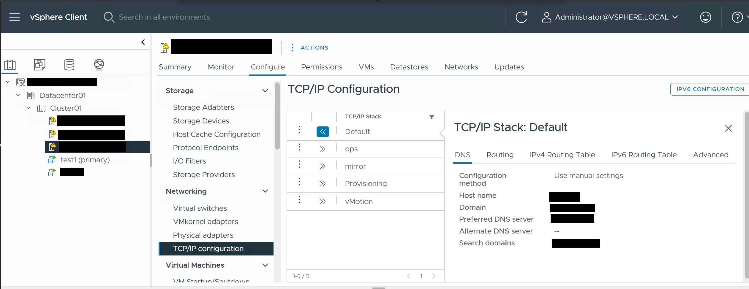

If the above doesn't work, follow the below steps:
  • Navigate to the vCenter Server UI.
  • Select the affected ESXi host > Configure > Networking > TCP/IP configuration.
  • Select the Default TCP/IP stack > Edit.
  • Configure the correct Domain name and Host name to establish the complete FQDN.
  • Rerun the SDDC Manager precheck.
