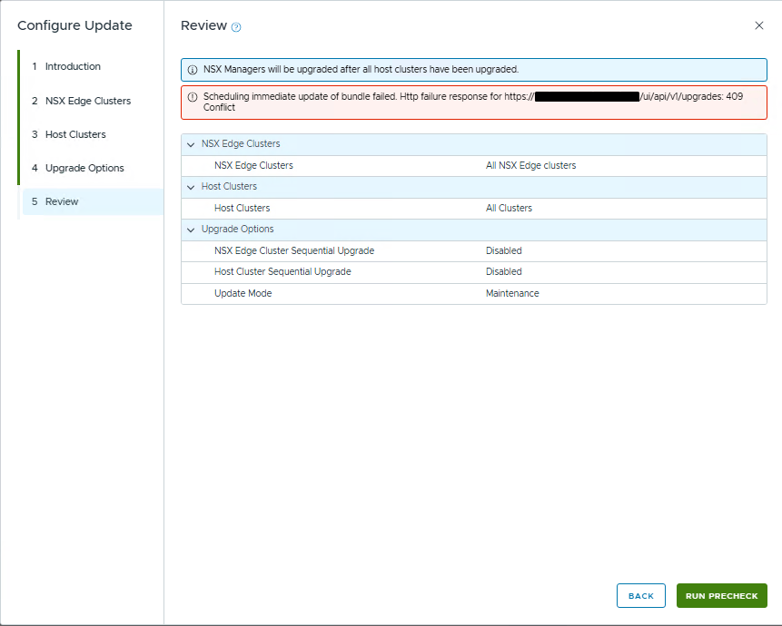

SDDC Prechecks error "Scheduling immediate update of bundle failed. Http failure response for https://#########/ui/api/v1/upgrades: 409 Conflict" for NSX Upgrade.
Article ID: 432980
VMware NSX VMware vSphere ESXi
SDDC Manager appliance UI error:
VMware NSX
VMware Cloud Foundation
This issue occurs when there is a bundle ID mismatch present in the SDDC Manager database.
