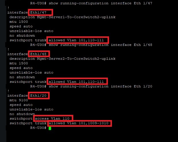

The Inter-Switch Link (ISL) connecting the two upstream physical network switches is misconfigured. Specifically, the ISL trunk port is missing the required VM VLANs.
When East-West traffic between VMs pinned to different active physical NICs traverses the ISL, the physical switch drops the packets.
Resolution:
  • Engage the network administration team to modify the physical switch configuration.
  • Identify the physical switch ports connected to the ESXi host uplinks (e.g., Eth1/47 and Eth1/48).
  • Identify the Inter-Switch Link (ISL) port connecting the two physical switches (e.g., Eth1/20).
  • Add the required VM VLAN IDs to the allowed VLAN list on the ISL trunk port.
    • Example of misconfiguration: VLAN 111 is missing from Eth1/20, which is an ISL interface.
