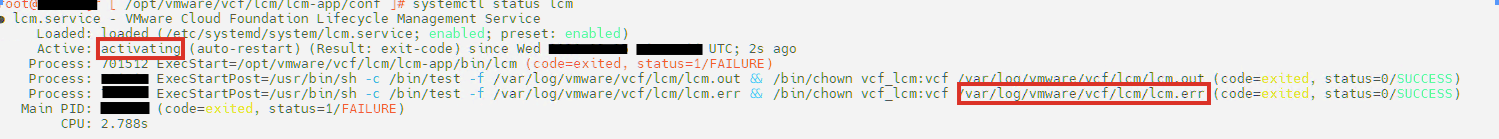

  • systemctl status lcm shows the service is in activating (auto-restart) loop as below,

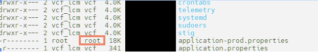

  • File permissions for  application-prod.properties in the path /opt/vmware/vcf/lcm/lcm-app/conf/ shows the owner as "root" instead of "vcf"

  5. Validate the ownership of the file at path "application-prod.properties" by running "ls -ltrh" from the directory /opt/vmware/vcf/lcm/lcm-app/conf.
  6. If the ownership of application-prod.properties is not the vcf user, update it using the following command:
    chown application-prod.properties vcf_lcm:vcf

  8. Verify the service status:
