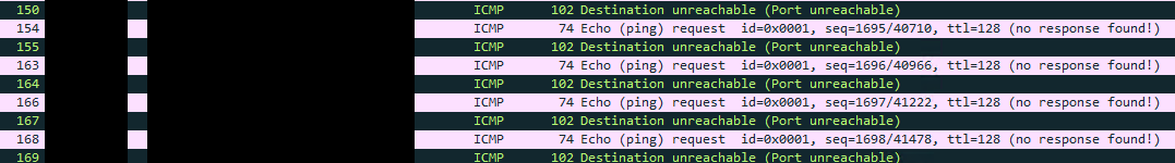

  • Review the captures. If "port unreachable" entries appear, or if UDP 902 packets are sent by the host but not received by vCenter, the issue is likely due to physical network congestion.
    Packet capture on a virtual machine from the ESXi host shows the VM is unreachable during the backup window:

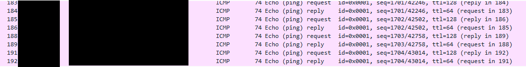

    Packet capture on a virtual machine post backup activity is completed:
