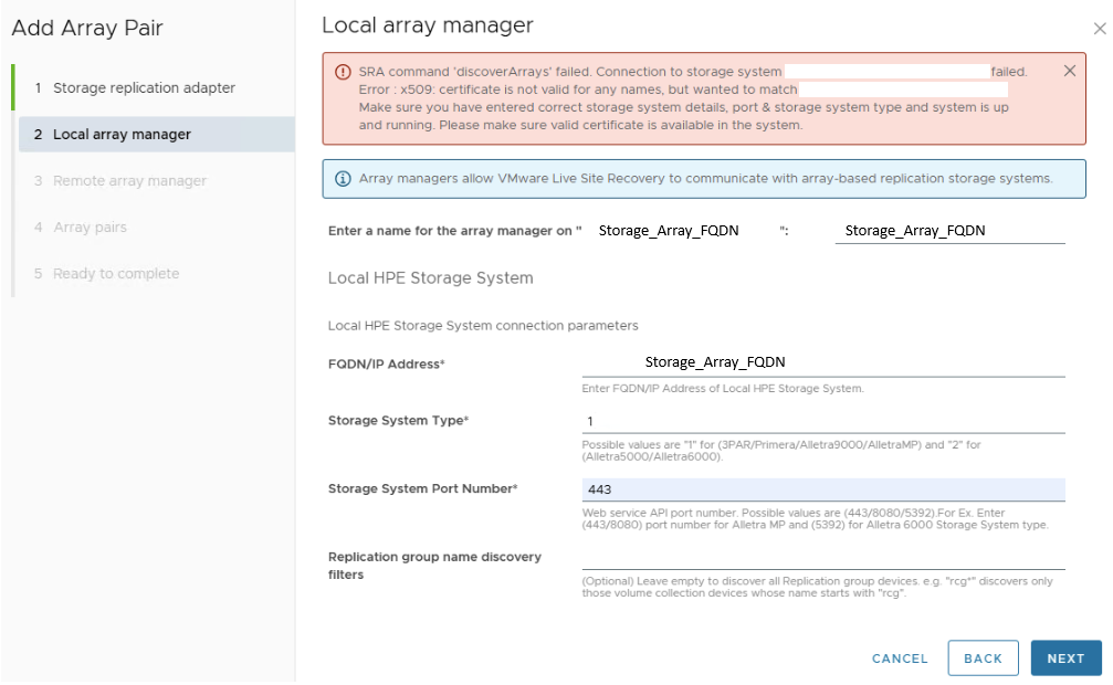

  • The administrator is unable to configure a storage array pair within VMware Live Recovery (VLR) version 9.0.4.
  • The configuration fails when attempting to use either the Fully Qualified Domain Name (FQDN) (e.g., Storage_array.Domain.com) or the management IP address.
  • The following certificate validation error surfaces in the VLR management interface when pairing is attempted using the FQDN.
Error: SRA command 'discoverArrays' failed. Connection to storage system <Storage_array_FQDN> failed.
Error : x509: certificate is not valid for any names, but wanted to match <Storage_array_FQDN>.
Make sure you have entered correct storage system details, port & storage system type and system is up
and running. Please make sure valid certificate is available in the system.
Screenshot:
VMware Live recovery 9.x
The array manager configuration failure is caused by an SSL/TLS certificate name mismatch. The VLR appliance attempts to negotiate a secure connection utilizing the storage array's FQDN, but the presented certificate does not contain the FQDN in its identity fields.
