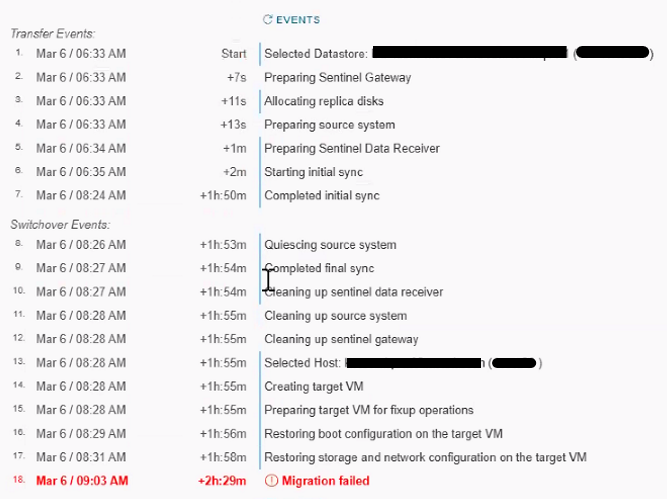

  • HCX OS Assisted Migration (OSAM) fails during the fixup phase for a Linux Virtual Machine.
  • You can see error stating "Failed to perform fix-up operation on migrated VM. Failed to finish fixup cleanup" under Services > Migration.

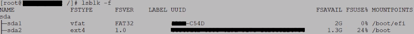

  • Checking the source linux Guest OS details confirm the partition to be FAT32 which is unsupported : lsblk -f
VMware HCX
The migration fails because the source Guest OS utilizes an unsupported FAT32 file system partition (such as /boot/efi). VMware HCX OS Assisted Migration (OSAM) does not support the FAT32 file system format for Linux fixup workflows.
Attempt the OSAM migration with the Guest OS having only supported file systems: ext2, ext3, ext4, XFS .
