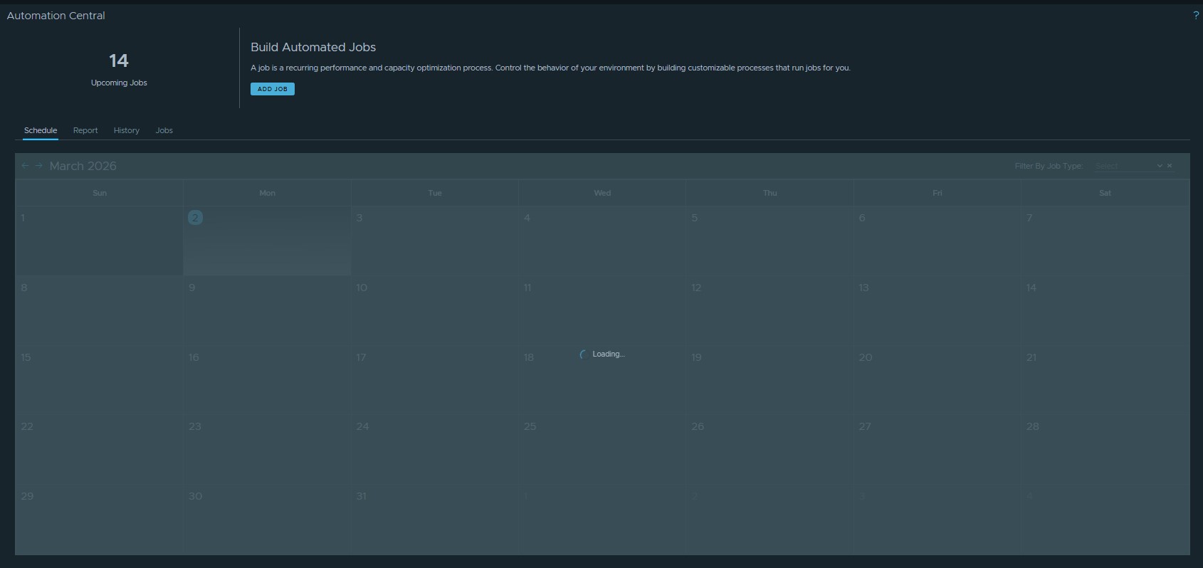

When you navigate to Automation Central > Schedule in VCF Operations (formerly VMware Aria Operations) 8.18.x, the page fails to load and displays a continuous loading spinner.
If you inspect the browser developer tools console, the following error is present: AppUtils.js:37 Uncaught RangeError: Invalid time zone specified: GMT-05:00
