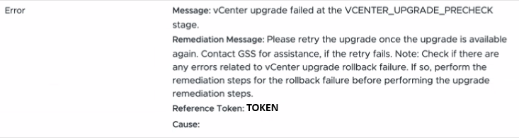

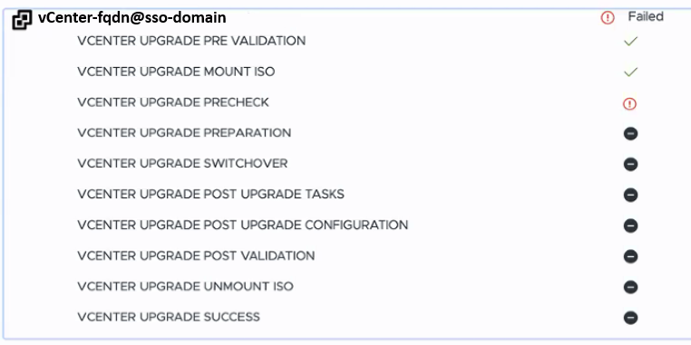

  • Under VCF Operations UI, vCenter upgrade fails at VCENTER UPGRADE PRECHECK stage.
  • Under the Task Info, below error message is available:
