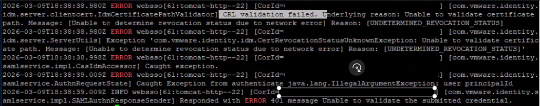

The error is found in /var/log/vmware/sso/websso.log: [Unable to determine revocation status due to network error]

Internal authentication services fail to route the Certificate Revocation List (CRL) check. While the OS-level routing is healthy, the application's internal DNS resolution prioritizes the CA's legacy IPv4 (A) record. In an IPv6-only environment, the appliance cannot route to this IPv4 address, causing the revocation check to fail.
[!NOTE] Verification: You can confirm the issue is caused by the CRL validation failure by temporarily disabling the CRL check. If logins succeed while the check is disabled, the routing conflict is confirmed.
