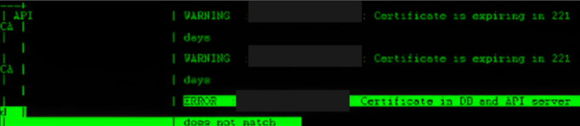

    • Though the CARR script's primary use is to find and replace expired and expiring self-signed certificates, it will also discover discrepancies in cases where the certificate listed within the database doesn't match the certificate listed for the server (such as API), and then resolve the discrepancy. See below for an example of what the CARR script output may return:
