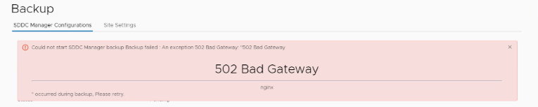

Symptoms:
Receive a 502 Bad Gateway error when triggering a manual backup from the SDDC UI.
Similar scenario as KB https://knowledge.broadcom.com/external/article?articleNumber=327193
Service has same behavior, as in the aforementioned KB
