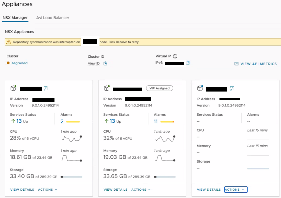

  • NSX UI System > Appliances (First NSX Manager Node to be upgraded):
    • Service Status, CPU, Memory, Storage and Alarms may not display a reading
    • Version is the current (pre-upgraded) NSX version
    • Cluster status is 'degraded'.
