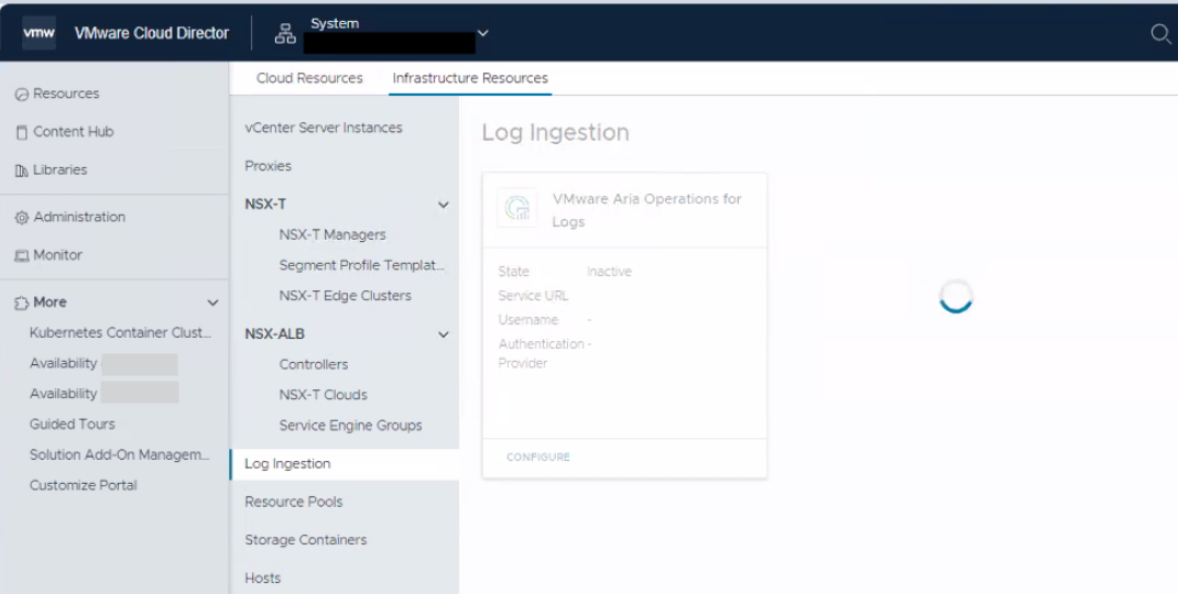

  • While configuring Log Ingestion in VMware Cloud Director (VCD), the configuration process may remain stuck on the loading screen and does not progress further.
Navigation path: VCD Provider Portal → Resources → Infrastructure Resources → Log Ingestion → Configure → Enter Aria Operations for Logs details → Save → Trust Aria Operations for Logs certificate

  • If you navigate to another tab in the VCD Provider Portal and then return to Log Ingestion, the status appears as Inactive, with an option to configure it again

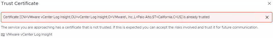

  • When attempting the configuration again, the system prompts you to trust the certificate, after trusting the certificate, the following error appears : Certificate is already trusted

Configuring Log Ingestion get stuck when the Aria Operations for Logs certificate does not include the address used during configuration (either IP address or FQDN) in the Subject Alternative Name (SAN) field.
The error “Certificate is already trusted” occurs when a previously trusted Aria Operations for Logs certificate still exists in the VCD Trusted Certificates store. When the same certificate is presented again during configuration, VCD identifies it as an already trusted certificate and blocks the integration to prevent duplicate or stale certificate entries.
To resolve the issue, remove the existing Aria Logs certificate(if any) from VCD Trust Store and reconfigure Log Ingestion in VMware Cloud Director.
