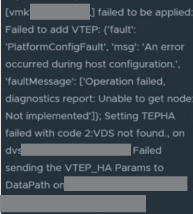

[vmk1X.X.X.X,] failed to be applied: Failed to add VTEP: {'fault': 'PlatformConfigFault', 'msg': 'An error occurred during host configuration.', 'faultMessage': ['Operation failed diagnostics report: Unable to get node:
Not implemented']); Setting TEPHA failed with code 2:VDS not found., on dvs <DVS-Name>; Failed sending the VTEP_HA Params to DataPath on dvsVMware NSX
The issue is typically caused by a desynchronization between the ESXi host's local management agents and the NSX Controller plane.
