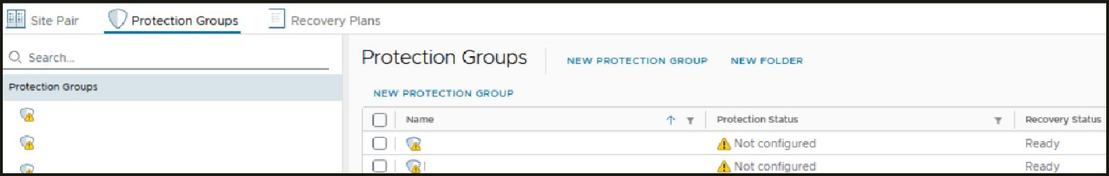

  • SRM UI reports all the "Protection group" as not configured state whenever the NetApp SRA 10.5 is being deployed.

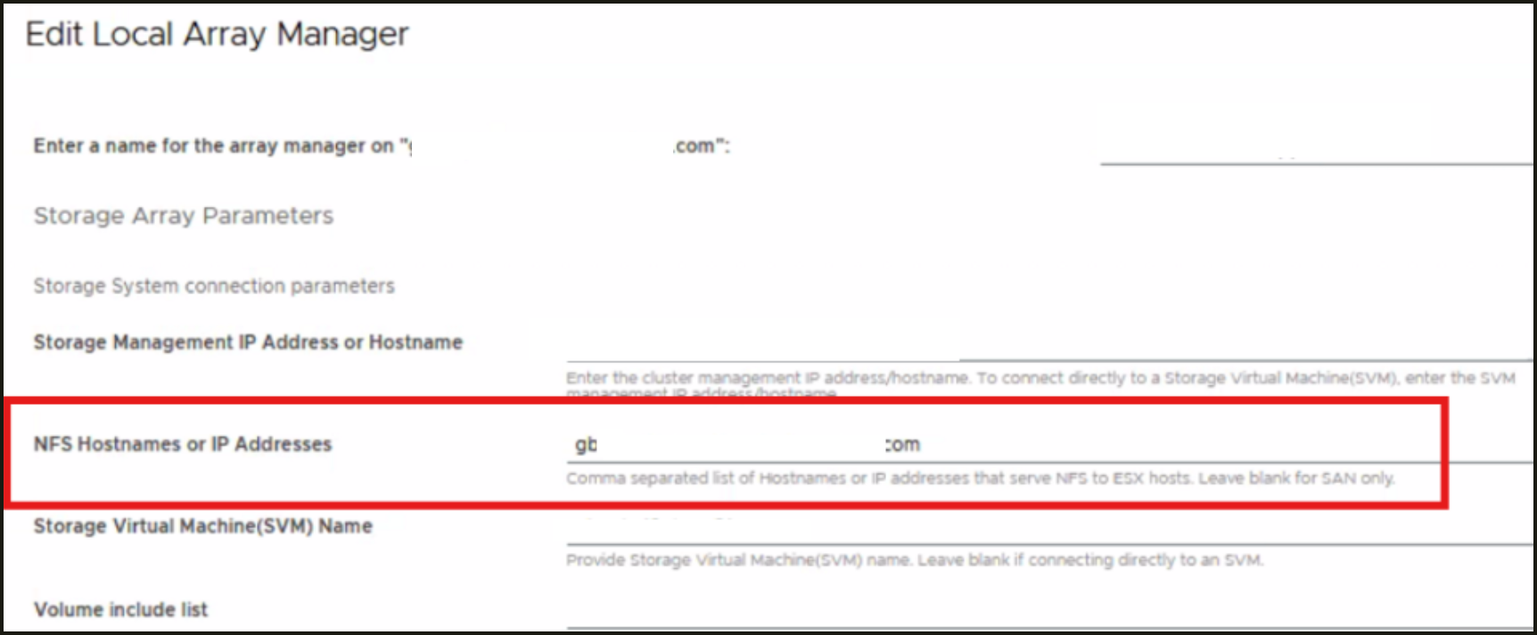

A mismatch or conflict in the NFS details between the ESXi host’s device backing of the NFS datastore and the NFS list on the array manager causes the protection group to appear in a “Not Configured” state and results in the VMs being marked as Invalid.
Due to the issue on SRA version 10.5, It requires an NFS IP to updated on the SRM array manager instead of the FQDN. But since the NFS datastore on the ESXi host is mounted via FQDN there are configuration issues seen.
 "Discoverdevices" fails with "Storageports" not found are observed when the NFS hostnames or IP address is updated with FQDN.

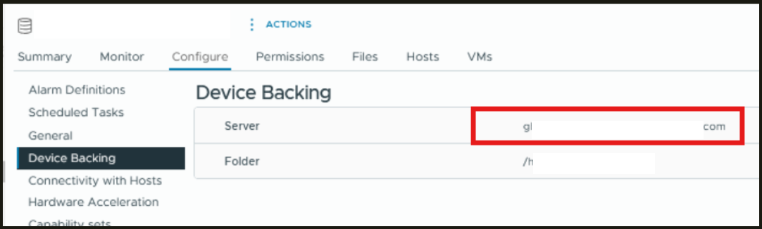

Sametime on the ESXi host, we see that NFS datastore's device backing populated with FQDN
Due to the mismatch of the NFS details , The protection group on SRM shows configuration issues as it is unable to evaluate the correct NFS configurations.

1. On SRM UI, Edit the local array manager and update with  NFS IP instead of FQDN.

4. On the "VC UI > Datastores"  right click >  Mount the NFS datastore with NFS IP instead of FQDN . So by doing this we are matching the NFS details with the array manager on the SRM UI. This makes sure that the backing device is correctly mapped with NFS details on the array manager.
