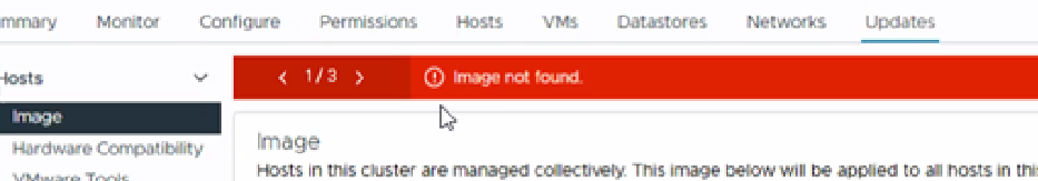

- ESXi hosts report the error: "HA Agent cannot be installed or configured".
- Navigating to the vSphere Client > Cluster > Updates > Image tab displays an "Image not found" error when attempting to view or apply the desired image to the cluster.
