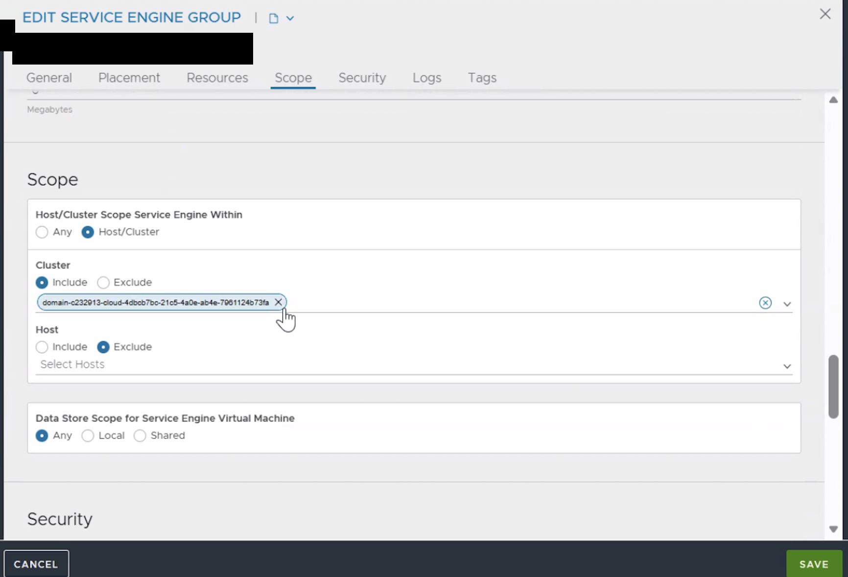

If there are overrides to the SE management network or if you scoped out the ESX cluster, ESX hosts, or datastore on SE Groups and these objects were removed from the vCenter DC the migration of the vCenter cloud will also fail and the upgrade will fail/abort with the same error.
When the object no longer exists the SE Group will populate/present the object as a UUID instead of the name of the object in the GUI.
Example:
