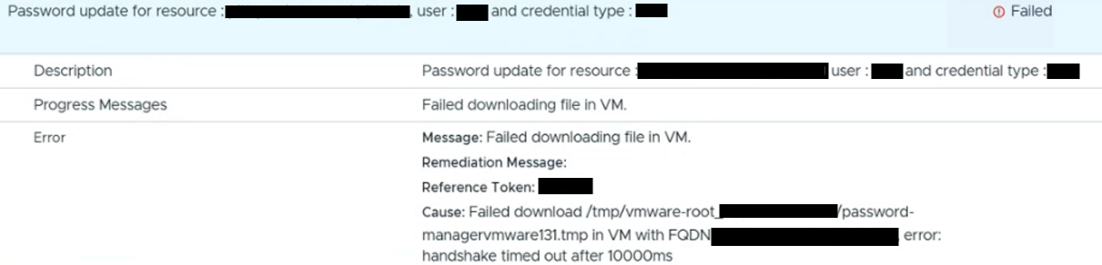

  • In the SDDC Manager UI, ESXi and vCenter service/root accounts are in a disconnected state.
  • Attempts to remediate or update the passwords for these accounts fail. The task fails with the following error message:
    error: handshake timed out after 10000ms
