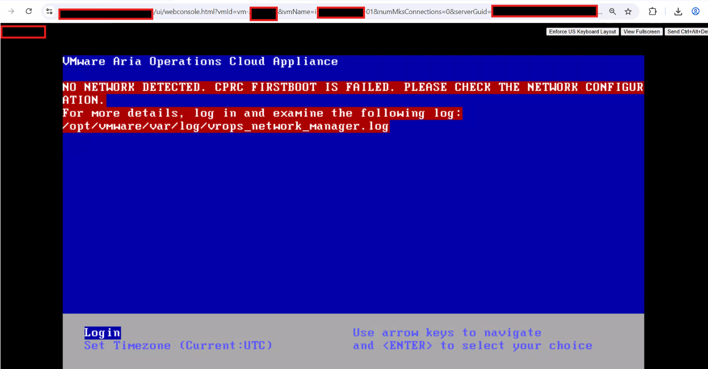

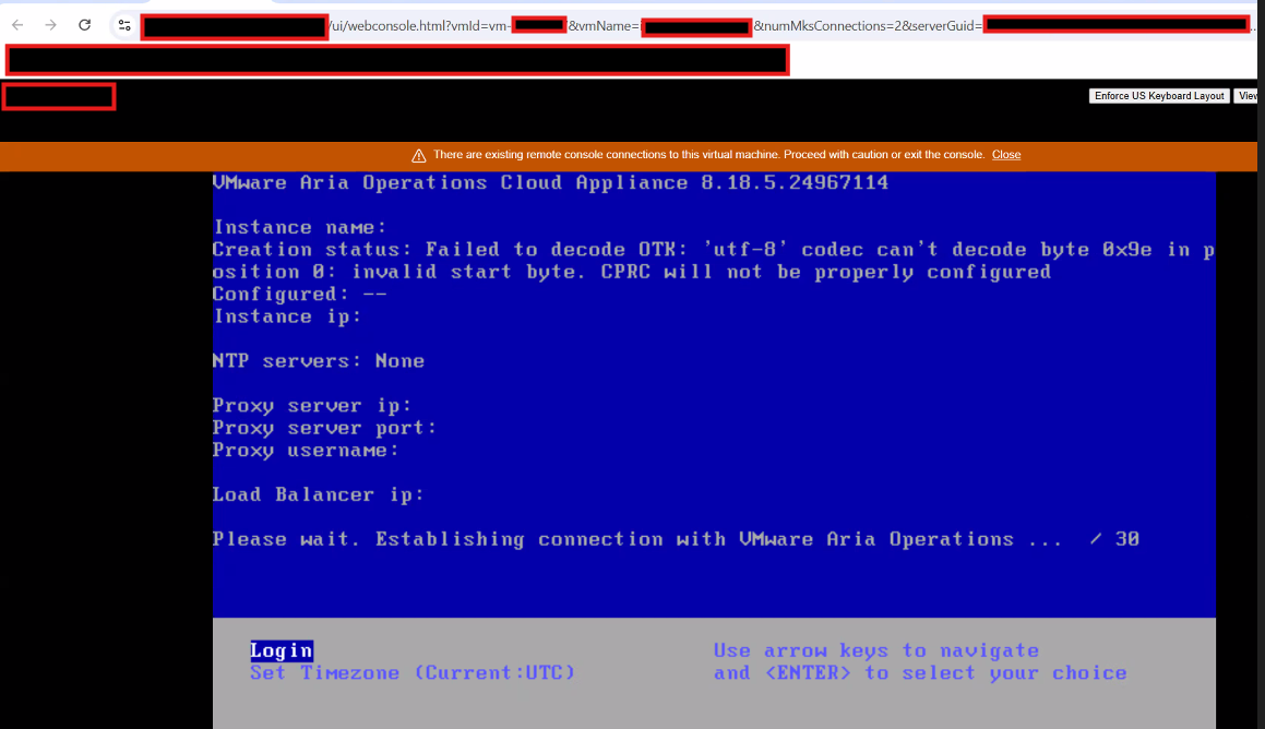

Following errors on Guest will be observed while trying to deploy Cloud Proxy either through Aria Operations or direct OVA deployment over ESXi -
  • Failed to decode OTK: 'utf-8' codec can't decode byte 0x9e in position 0: invalid start byte. CPRC will not be properly configured.
  • VMware Aria Operations Cloud Appliance
    NO NETWORK DETECTED. CPRC FIRSTBOOT IS FAILED. PLEASE CHECK THE NETWORK CONFIGURATION.
    For More details, log in and examine the following log:
    /opt/vMware/var/log/vrops_network_Manager. log
VMware Aria Operations 8.18.x
VCF Operations
Multiple causes for this issue -
  • DNS not reached
  • Wrong IP used
  • DNS IP not resolving
Check DNS settings and change IP if required and then re-deploy Cloud Proxy VM using steps from the following article-
Configuring Cloud Proxies in VMware Aria Operations
