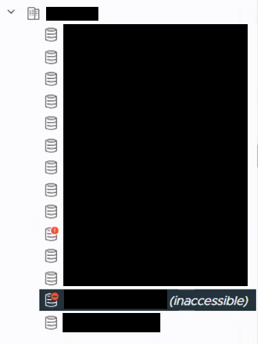

The datastore is inaccessible as the backend LUN is not visible to the ESXi host.
SCSI code H:0x1 below from the var/logs/vmkernel.log indicates the ESXi host is lost connection to the LUN. The LUN is no longer visible to the host.

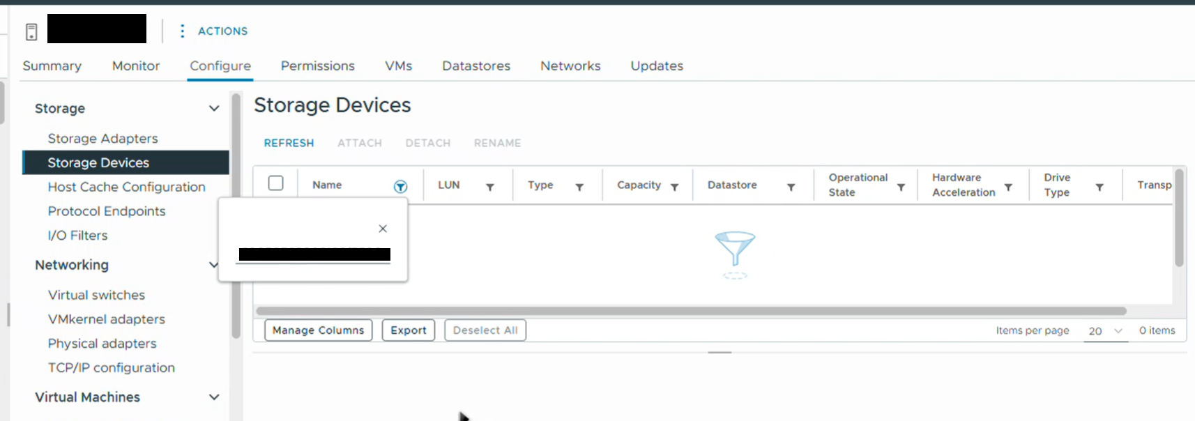

To resolve this issue:
1. A storage rescan or reboot on the host restores access to the device/datastore.
2. If issues persists engage your storage vendor support to investigate further on why the LUN is not accessible to the host.
