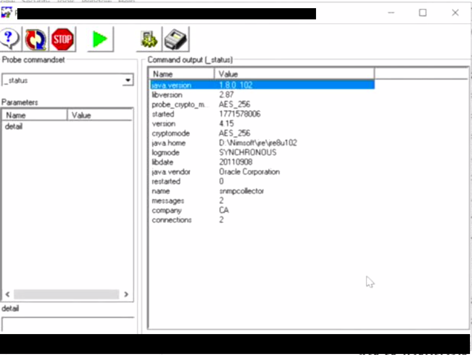

 at com.nimsoft.nimbus.Cryptographer.encrypt(C
Issue hubs had java 1.8 but old versions
Upgrade java_jre to latest 1.8 version from the Nimsoft archive fixes the issue
