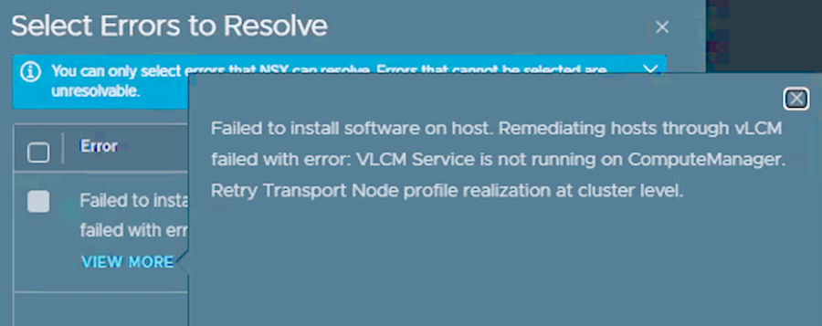

  • NSX manager showing errors “Failed to install software on host. Remediating hosts through vLCM failed with error: VLCM Service is not running on ComputeManager. Retry Transport Node profile realization at cluster level.”

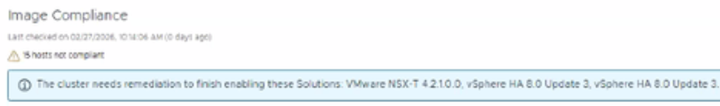

  • vCenter server cluster "Updates" compliance page showing the error.
