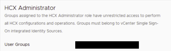

Add a group the user is a member of to the SSO group in vCenter.  Check the HCX Appliance Management Interface (VAMI):  https://<HCX-Manager-FQDN>:9443 > Configuration > HCX Role Mapping and check the User Group configured under the HCX Administrator.
Example:
In the SSO provider (typically vCenter), find the group configured in the HCX User Group example above
Add a Group the user is a member of to the group configured in the HCX Administrator > User Groups.
