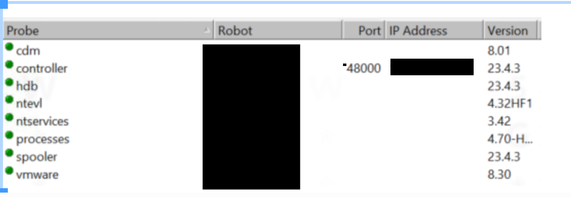

Deploying the vmware probe to any server the rest of the probes will not assign ip and port. Tested in 3 servers
windows 2 servers 2016 ,redhat-9 1 server .Same issue for all 3 servers.
UIM 23.4 CU3
VMware probe- 8.30

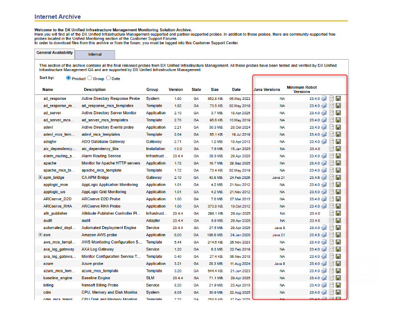

vmware probe 8.20 and above uses Java 21 and is compatible with 23.4CU5 and above and in this use case as running UIM 23.4CU3 whose robot is not compatible with java 21
The support archive also is now updated mentioning the compatibility
https://support.nimsoft.com/Default.aspx?center=felles/archive
In this use case as running 23.4 CU3 can deploy vmware provbe version 8.10 which uses java 1.8
