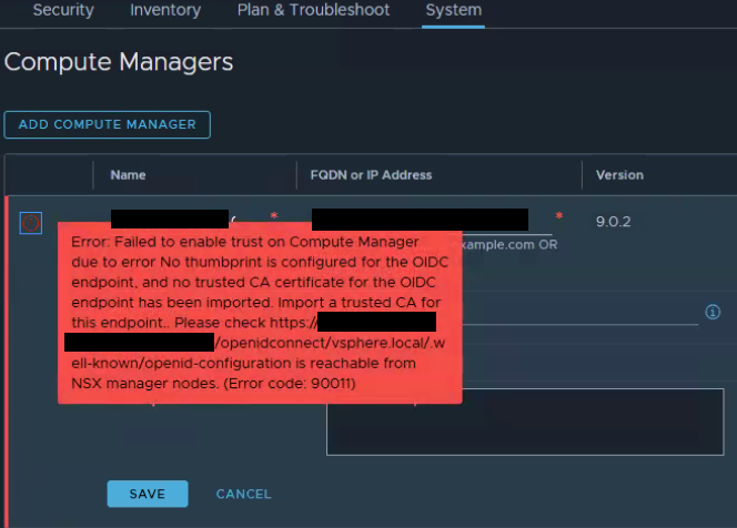

  • The following error is observed in the SDDC Manager UI during the task, as well as in the NSX Compute Manager UI:
    Error: Failed to enable trust on Compute Manager due to error No thumbprint is configured for the OIDC endpoint, and no trusted CA certificate for the OIDC endpoint has been imported. Import a trusted CA for this endpoint... (Error code: 90011)

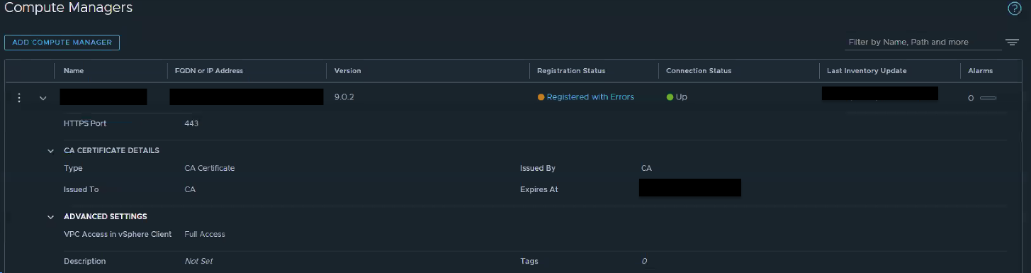

  • In the NSX UI (System > Compute Managers), the vCenter Compute Manager displays a Registration Status of "Registered with Errors".
