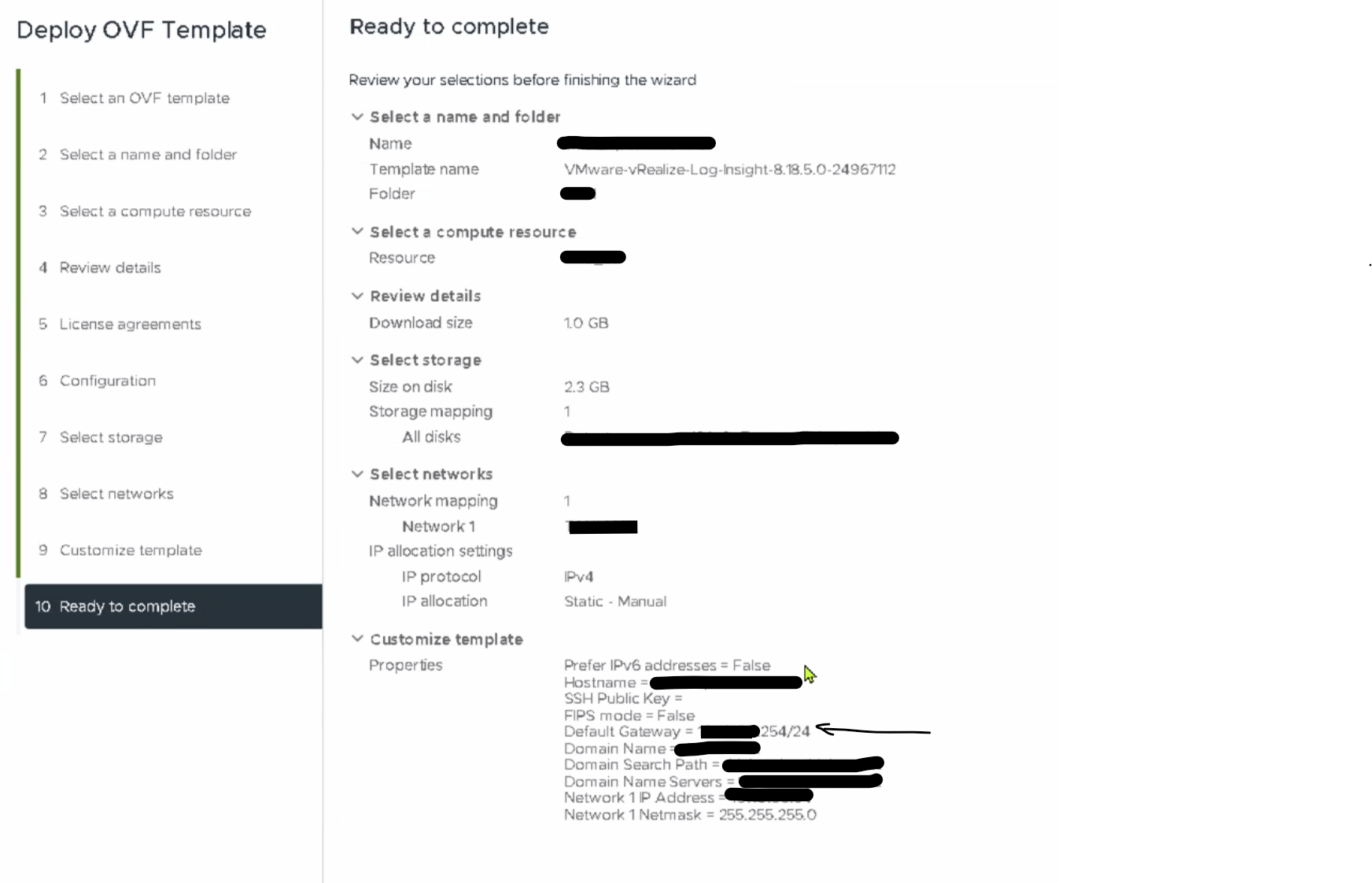

  • Deployment was performed with a CIDR suffix (e.g., /24) included in the Default Gateway field of the OVF template.

The root cause is a syntax error in the vApp properties where the Default Gateway contains CIDR notation (e.g., 10.x.x.254/24). Photon OS networking scripts expect the gateway field to contain only a valid IP address. When the /24 suffix is present, the routing command fails during the boot sequence, preventing the persistence of the network stack.

  4. Edit the value to remove the CIDR suffix (e.g., change 10.x.x.254/24 to 10.x.x.254).
