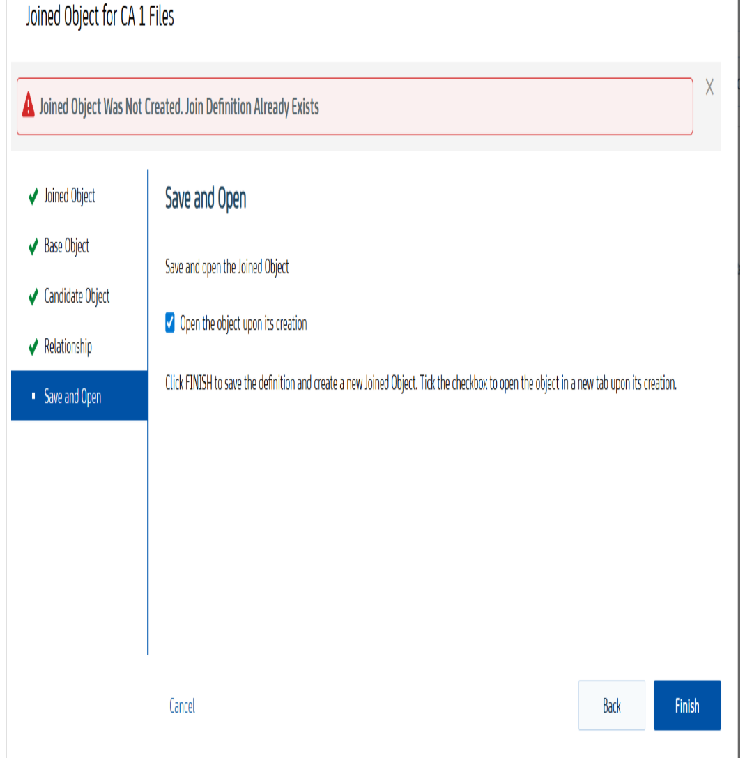

Attempting to create and new JOIN using CA 1 Files object as the Base Object and CA 1 Volumes object. Received the below error message, but there no JOIN Object with the same Join Name. No way to tell what JOIN Object Name (PDS Member name) is that it’s saying is a duplicate. Following is the screenshot of the error message displayed on the web client.
We checked the main task for MVS errors but didn't see any.
