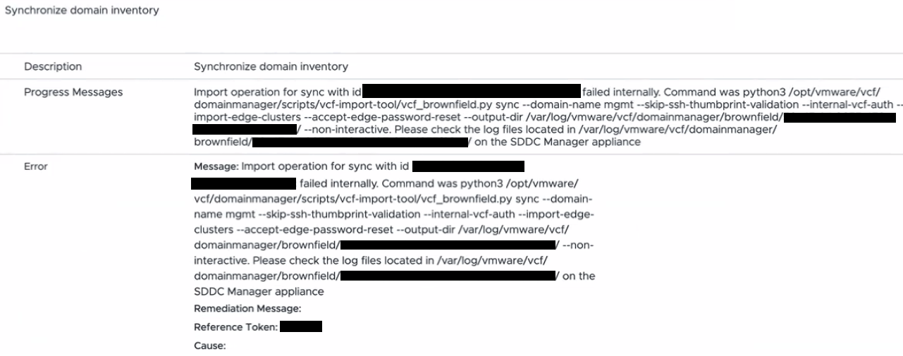

  • When performing a Sync Inventory or a Brownfield import in VMware Cloud Foundation (VCF) Operations 9.x, the process fails during the guardrail validation phase.
  • In the VCF Operations UI, the following error message is displayed:

    YYYY-MM-DDTHH:MM:SS.894+0000 ERROR [vcf_dm,###############,####] [c.v.e.s.o.model.error.ErrorFactory,dm-exec-##] [TOKEN] IMPORT_OPERATION_FAILED Import operation for sync with id ########-####-####-######## failed internally. Command was python3 /opt/vmware/vcf/domainmanager/scripts/vcf-import-tool/vcf_brownfield.py sync -- domain-name mgmt -- skip-ssh-thumbprint-validation -- internal-vcf-auth -- import-edge-clusters -- accept-edge-password-reset -- output-dir /var/log/vmware/vcf/domainmanager/brownfield/########-####-####-########/ -- non-interactive. Please check the log files located in /var/log/vmware/vcf/domainmanager/brownfield/########-####-####-########/ on the SDDC Manager appliance
    com. vmware. evo.sddc.orchestrator. exceptions. OrchTaskException: Import operation for sync with id ########-####-####-######## failed internally. Command was python3 /opt/vmware/vcf/domainmanager/scripts/vcf-import-tool/vcf_brownfield.py sync -- domain-name mgmt -- skip-ssh-thumbprint-validation -- internal-vcf-auth -- import-edge-clusters -- accept-edge-password-reset -- output-dir /var/log/vmware/vcf/domainmanager/brownfield/########-####-####-########/ -- non-interactive. Please check the log files located in /var/log/vmware/vcf/domainmanager/brownfield/########-####-####-########/ on the SDDC Manager appliance
