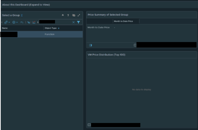

Month-to-Date (MTD) pricing and Summary|Metering price metrics do not populate for Virtual Machines and Custom Groups.
When this issue occurs, the daily Cost metrics calculate successfully, and the pricing policy (configured as "Based on Cost") is confirmed to be correctly assigned to the respective objects. Despite this, the corresponding pricing data remains blank in the dashboards and metric charts.

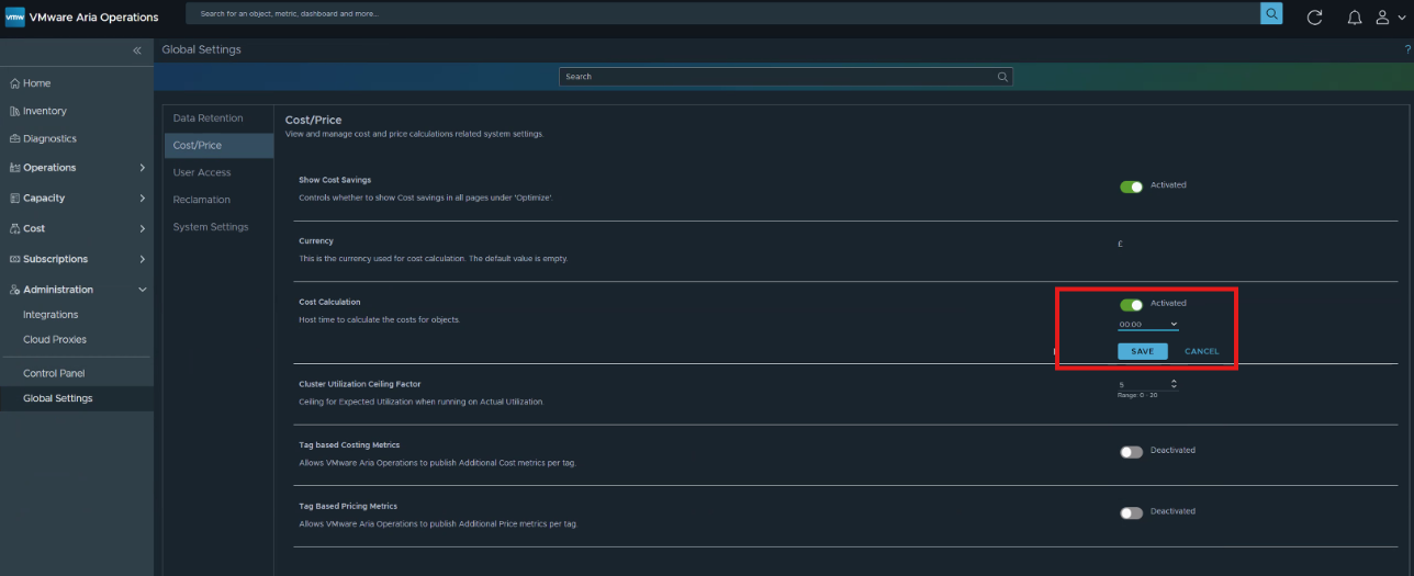

To resolve this issue and restore the data flow for MTD Price and Metering metrics, apply the following steps:
  1. Alleviate Resource Constraints: Review the current cluster sizing against the official sizing guidelines. If the cluster is at capacity (especially with HA enabled), perform a Vertical Scale Up of the Analytics nodes (e.g., from Large to Extra Large - 32 vCPU / 128 GB RAM) via Aria Suite Lifecycle.
  2. Synchronize Calculation Engines: Modify the Cost calculation schedule to run at 12:00 AM Host time as shown below. This ensures that the Cost calculations have ample time to complete before the UTC-scheduled Pricing engine triggers.
