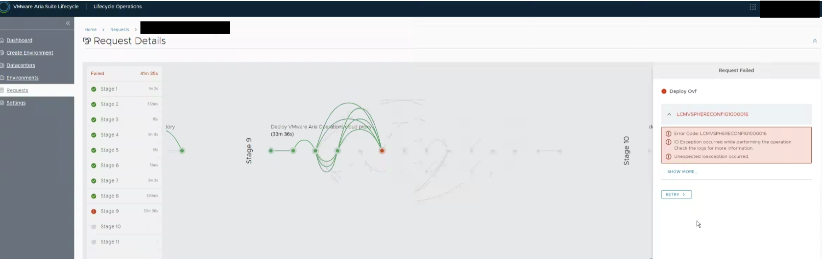

During the deployment of VMware Aria Operations cloud proxies via vRealize Suite Lifecycle Manager (vRSLCM / vRLCM), the process fails to complete. Inspection of the "Request details" execution pane in the vRLCM interface indicates that the deployment task halts specifically at stage #9.
