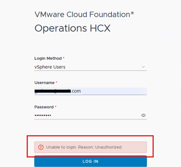

Unable to login. Reason:Unauthorized".<timestamps> UTC [http-nio-8443-exec-10, , , TxId: ] INFO c.v.v.h.a.HybridityAuthenticationEntryPoint- AuthenticationEntryPoint - unauthorized request for URI /hybridity/api/sessions
<timestamps> UTC [http-nio-8443-exec-10, , , TxId: ] ERROR c.v.v.h.a.HybridityAuthenticationEntryPoint- AuthenticationEntryPoint - got AuthenticationException
org.springframework.security.authentication.BadCredentialsException: Error validating user <ad-username>: Status code: 500, Reason: Internal Server Error<?xml version='1.0' encoding='UTF-8'?><S:Envelope xmlns:S="http://schemas.xmlsoap.org/soap/envelope/"><S:Body><S:Fault xmlns:ns4="http://www.w3.org/2003/05/soap-envelope"><faultcode xmlns:ns0="http://docs.oasis-open.org/ws-sx/ws-trust/200512">ns0:FailedAuthentication</faultcode><faultstring>Invalid credentials</faultstring></S:Fault></S:Body></S:Envelope>
<timestamps> UTC [http-nio-8443-exec-10, , , TxId: ] ERROR c.v.v.h.a.HybridityAuthenticationEntryPoint- Sending Response Error 401 for /hybridity/api/sessions
/var/log/vmware/sso/vmware-identity-sts.log :<timestamps> INFO sts[78:tomcat-http--40] [CorId=####-602e-####-8c1a-ca27b2b0b8de] [com.vmware.identity.sts.impl.STSImpl] Entering issue() token...
<timestamps> ERROR sts[78:tomcat-http--40] [CorId=####-602e-####-8c1a-ca27b2b0b8de] [com.vmware.vcenter.tokenservice.external.identitymanagement.ExternalIdentityManagementProvider] Login failure for user {Name: <username>, Domain: <domain-name>}
javax.security.auth.login.LoginException: Login Failed to server https://<vc-fqdn-ip>/acs/t/CUSTOMER/token with Response code: 400. Message: Bad Request
/var/log/vmware/vc-ws1a-broker/accesscontrol-service-10.log :<timestamps> ERROR <vc-fqdn-ip>:accesscontrol (ForkJoinPool-5-worker-4) [CUSTOMER;-;127.0.0.1;####-####-####-ca62d1bea0d2;-;####;password]
com.vmware.vidm.accesscontrol.tokengranter.password.FederationPasswordTokenGranter - FAILURE: Call to Federation failed with status FAILURE and message invalid_grant: AADSTS50076: Due to a configuration change made by your administrator, or because you moved to a new location, you must use multi-factor authentication to access '#######-0000-0000-c000-000000000000'. Trace ID: ####-####-####-ac9093370900 Correlation ID: ####-####-####-a8ba6bae78cb Timestamp: <timestamps>
<timestamps> WARN <vc-fqdn-ip>:accesscontrol (ForkJoinPool-5-worker-5) [CUSTOMER;-;127.0.0.1;####-####-####-ca62d1bea0d2;-;####;password]
com.vmware.vidm.accesscontrol.resource.auth.TokenResource - Failed during issuing token java.util.concurrent.CompletionException: com.vmware.vidm.accesscontrol.exceptions.oauth2.InvalidGrantException
: invalid.user.or.password
VMware HCX 9.x
vCenter 8.x
Microsoft Entra ID with multi factor authentication
Authentication to the HCX UI (port 443) using Active Directory credentials is unsupported when vCenter Single Sign-On is integrated with Microsoft Entra ID enforcing Multi-Factor Authentication (MFA).
Authentication to the HCX UI (port 443) using Active Directory credentials is unsupported when vCenter Single Sign-On is integrated with Microsoft Entra ID enforcing Multi-Factor Authentication (MFA). This authentication flow is only supported in VMware Cloud Foundation (VCF) 9.x environments where the VCF Identity Broker is deployed and HCX is configured to use VCF SSO.
WORKAROUND:
Please use VC SSO local accounts.
OR
Configure Microsoft Entra ID without enforcing Multi-Factor Authentication (MFA)
