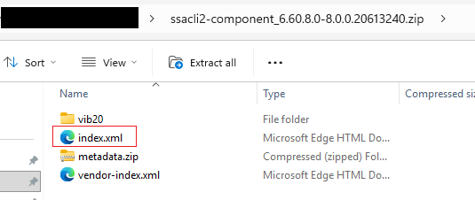

  • Vendor code mismatch can be verified by checking the value for <code> in Index.xml file. The VIB needs to be extracted using 7-zip or any other equivalent tool to check the Index.xml.

  1. Extract the VIB with the conflicting vendor code (in this example ssacli2-component_6.60.8.0-8.0.0.20613240.zip)
  2. Edit the file Index.xml file in the extracted content:
  3. Modify the value for code from lowercase to uppercase to match with the conflicting VIB:
