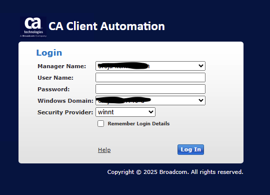

When trying to login to Web Console using any credentials, the login is attempted, the page refreshes and then it shows again the login page, no error is shown:

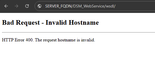

And when trying to open the WSDL from the browser (using the one shown in the log above), the same error 400 is shown:

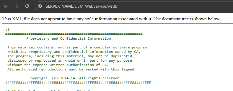

But when using the server name instead, the WSDL URL opens correctly:
