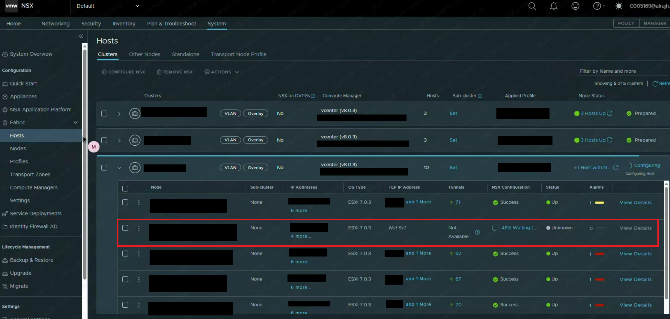

When adding new ESXi hosts to a vCenter environment managed by NSX, the host preparation process (NSX installation) fails to complete. The installation progress typically hangs at 48% before eventually timing out or failing with a registration error.
Analysis of the nsx-syslog.log on the affected ESXi host reveals a socket.gaierror:
Failed to connect to <NSX-Manager-FQDN> port 443: [Errno -2] Name or service not known
Node registration failed: 'NSX Manager API certificate is not valid: curl_wrapper: (28) Failed to connect to <NSX-Manager-FQDN> port 443'
This error confirms that the curl_wrapper used by the NSX installation script cannot translate the FQDN into an IP address.
