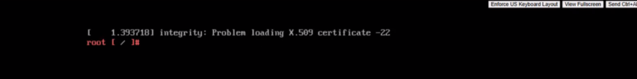

  • The VMware Live Recovery (VLR) 9.0.4 appliance becomes inaccessible after an attempted converge operation.
  • Rebooting the appliance fails during the service initialization phase.
  • The appliance console displays the following error message:
                    "Integrity: Problem loading X.509 certificate -22"
  • Multiple services are skipped during the boot process, leaving the appliance in a non-operational state
VMware Live Recovery : 9.0.4
This condition is caused by the presence of legacy (non-enhanced) replication data during the convergence workflow to VLR 9.0.4. The convergence process is designed to require that all existing replications be migrated to an enhanced replication state prior to execution. If legacy replications remain registered within the database, a ServiceExportFault is triggered, resulting in an incomplete architectural state and service failure.
