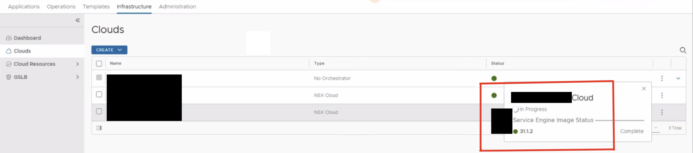

  • In the VMware AVI Load Balancer UI, the NSX-T Data Center Cloud may remain stuck in “In Progress” state under:
Infrastructure --> Clouds

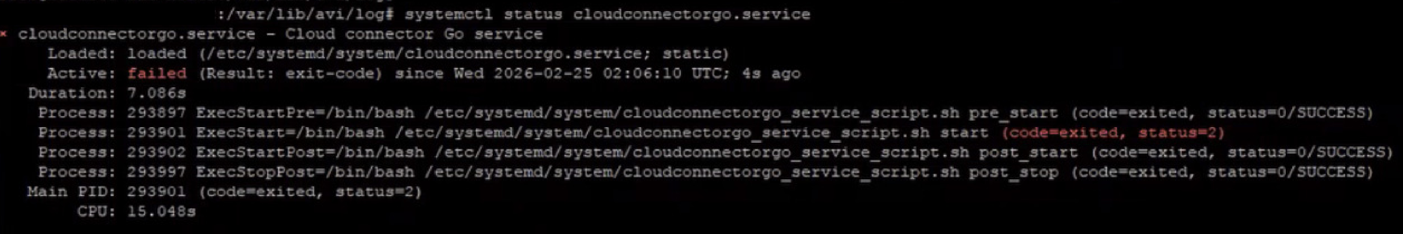

  • The cloudconnectorgo.service will be in a failed state on the controller leader node. You can verify this by running the following command
         systemctl status cloudconnectorgo.service
