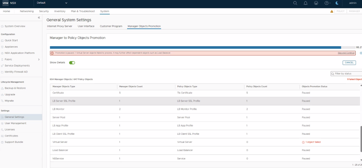

Promote manager objects to policy. Failed with error "Promotion is paused 1 Virtual Server objects failed to process. It may further affect dependent objects such as Load Balancer"
Article ID: 431529
VMware NSX

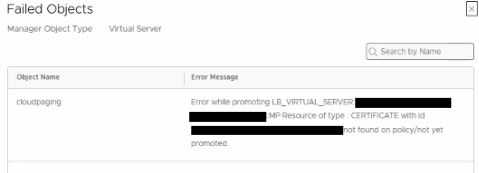

Screenshot of the error during the time of migration process manager to policy:
Failed objects:
VMware NSX-T Data Center
VMware NSX
This failure typically occurs when a stale certificate is associated with a Load Balancer Virtual Server. During the migration/promotion process, the system validates all referenced objects; if a certificate is stale, the promotion of the Virtual Server (and its parent Load Balancer) cannot proceed from Manager to Policy.
Specifically, the issue is often found within the Client-Side or Server-Side SSL profiles attached to the Virtual Server.

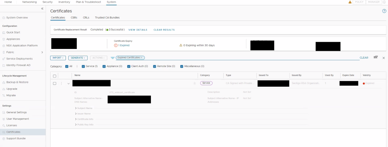

Below is a screenshot of the stale certificate.
To resume the promotion, you must identify and remove the stale certificate reference from the affected Virtual Server(s).

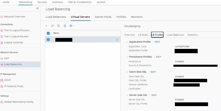

Step 2: Clear Stale Certificates from SSL Profiles
For each identified Virtual Server, perform the following:
  1. Click on the LB Profiles tab within the Virtual Server configuration.
  2. Check Client-Side SSL:
    • If Client Side SSL is enabled, click Edit.
    • Locate the Default Certificate field.
    • If the certificate is identified as stale or invalid, remove the entry or replace it with a valid certificate.
    • Save the changes.
  3. Check Server-Side SSL:
    • If Server Side SSL is enabled, click Edit.
    • If the stale certificate is present, remove the entry.
    • Save the changes.
