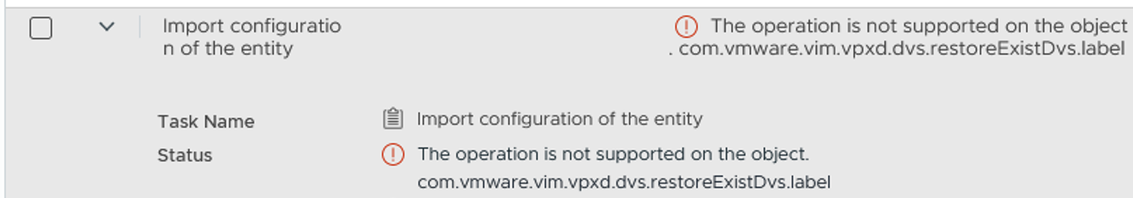

When attempting to import or restore a vSphere Distributed Switch (VDS) configuration in vCenter Server 8.x, the task fails with the following error:
"The operation is not supported on the object. com.vmware.vim.vpxd.dvs.restoreExistDvs.label"
This typically occurs during the "Import Distributed Switch" or "Restore Configuration" wizard.
