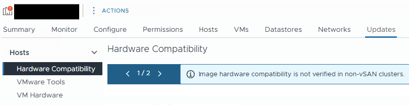

  • Active Directory (AD) authenticated users with Administrator privileges on vCenter Server are unable to see the Image section when navigating to Lifecycle Manager > Updates tab on one or more image-based clusters as shown below:

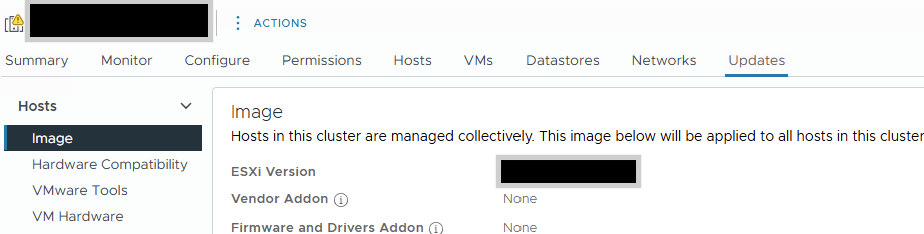

    On the other unaffected clusters, the Image section is accessible as shown below:

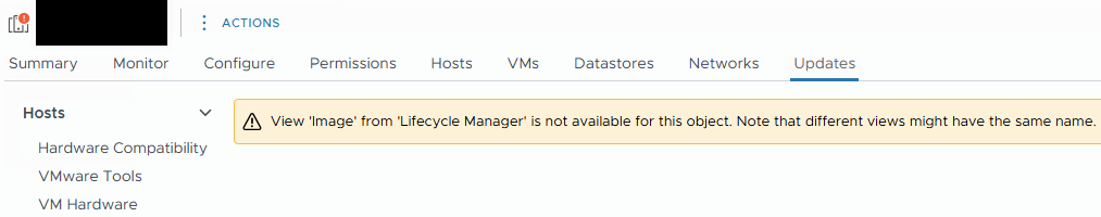

  • When navigating from the same Image section of Updates tab on an unaffected cluster to the affected cluster(s) to view the image, the following message is encountered in the vSphere Client:

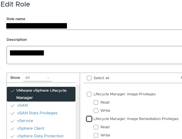

Explicit permissions defined at lower levels of the vSphere inventory hierarchy (e.g., the cluster level) override permissions inherited from higher levels (e.g., the datacenter level). In this scenario, one of the AD groups assigned directly at the cluster level has lesser privileges that supersedes the broader Administrator permissions inherited from the datacenter or vCenter level. This explicitly assigned role lacks the required VMware vSphere Lifecycle Manager > Lifecycle Manager: Image Remediation and Lifecycle Manager: Image privileges, blocking access to the Image section of Updates tab:

  • Modify the custom role assigned to the conflicting AD group by manually adding the VMware vSphere Lifecycle Manager > Lifecycle Manager: Image Remediation and Lifecycle Manager: Image privileges.
