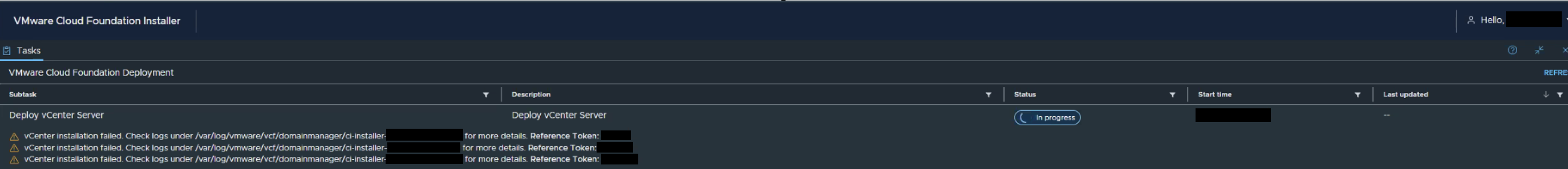

  • VMware Cloud Foundation installer fails during vCenter server installation. The installation completes and VAMI page shall be accessible, however, the installation rolls back, deleting the vCenter server instance. The VCF installer shows the error message similar to:
