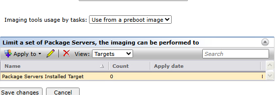

Controlling Package Server selection for imaging tasks
It applies specifically to Deployment Solution imaging tasks and works independently of Site/Subnet configuration. It narrows which Package Servers a client can use for imaging — it does not force a Package Server from one Site to serve a client registered in a different Site. Use it alongside proper Site boundaries, not as a substitute.
Two controls are available.
Deploy Image task: assign packages to specific Package Servers
By assigning the packages containing Ghost Images to a specific Package Server, you ensure clients download from that server during deployment.
  1. Open the SMP Console.
  2. Navigate to Manage, then Jobs and Tasks, then open your Deploy Image task.
  3. Click the Packages tab.
  4. For each package (for example, the package containing Ghost Images), click the row.
  5. In the package assignment area, select the Package Server(s) that should serve this package.
  6. Remove any Package Servers that should not serve this content.
  7. Click Save.
Screenshot of Deploy Image task, Packages tab, showing Package Server assignment per package

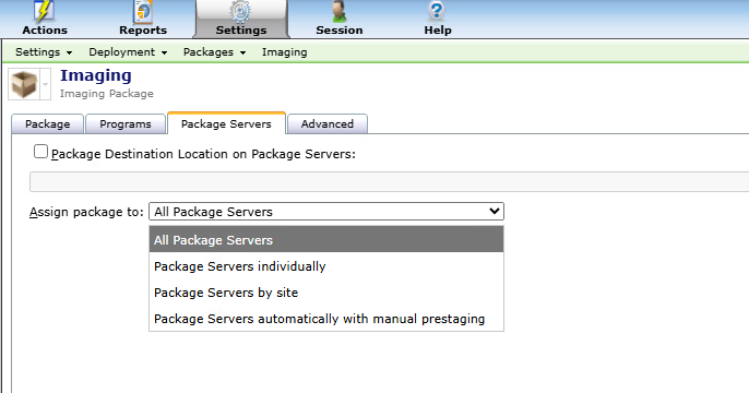

Note: The example references the "Imaging" Package, which contains the Ghost tool itself, not the actual Ghost Images. Assign the correct Ghost Image packages here, not just the Ghost tool package.
